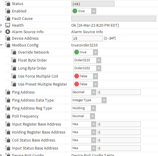

Niagara device setup under the modbus driver.
Note the byte order and use preset multiple register settings between them. Some do not support the modbus function codes for multi register read/write.
The PZEM-016 only supports 9600-8-1-n.
PAC5000
PAC5000 Device Setup.png (29.89 KiB) Viewed 148684 times

They all seem to work fine for my needs. The PAC5000 lines up with the utility read as far as I can tell. Get get the dates from the utility, but taking first and last readings on the dates they give its to a few kwh.
