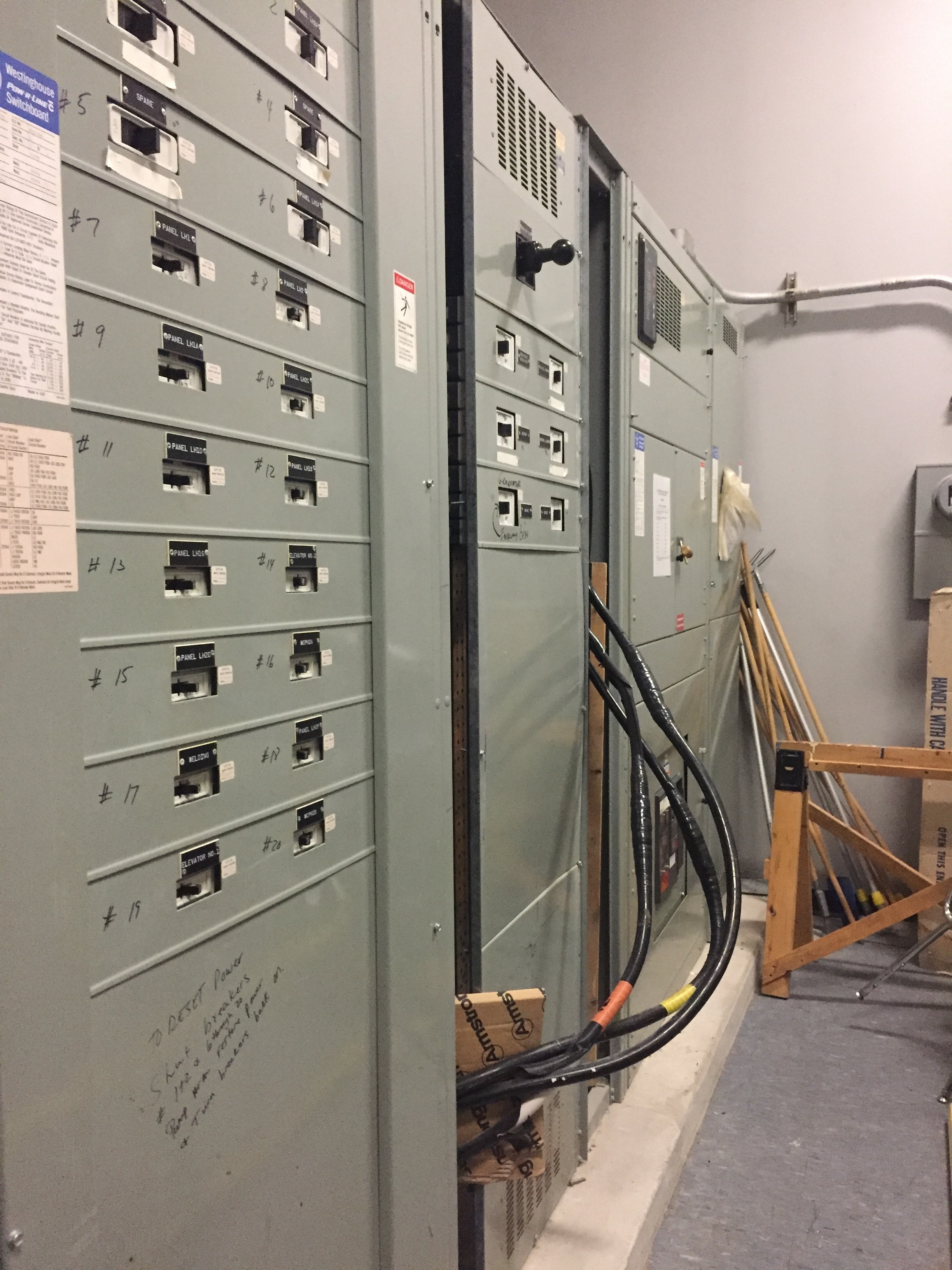

Tiny jumper wire in a electrical room of a school. Icing on the cake, the normally locked door to enter is screwed up and anyone can just walk in.
Copper thieves, curious kids...play with this!

Was it a permanent fix? I see stuff like this so much on construction it doesn't even phase me any more.

From what I was told, that's was the fix and it had been like that for some time.

Seen some really crappy things that just seem to hang around like that. Far as I'm concerned certificate of occupancy should require renewal every 10 years or so. Especially for things like schools and government buildings, those should set the standard. Also somehow churches get a huge pass on lots of stuff.
