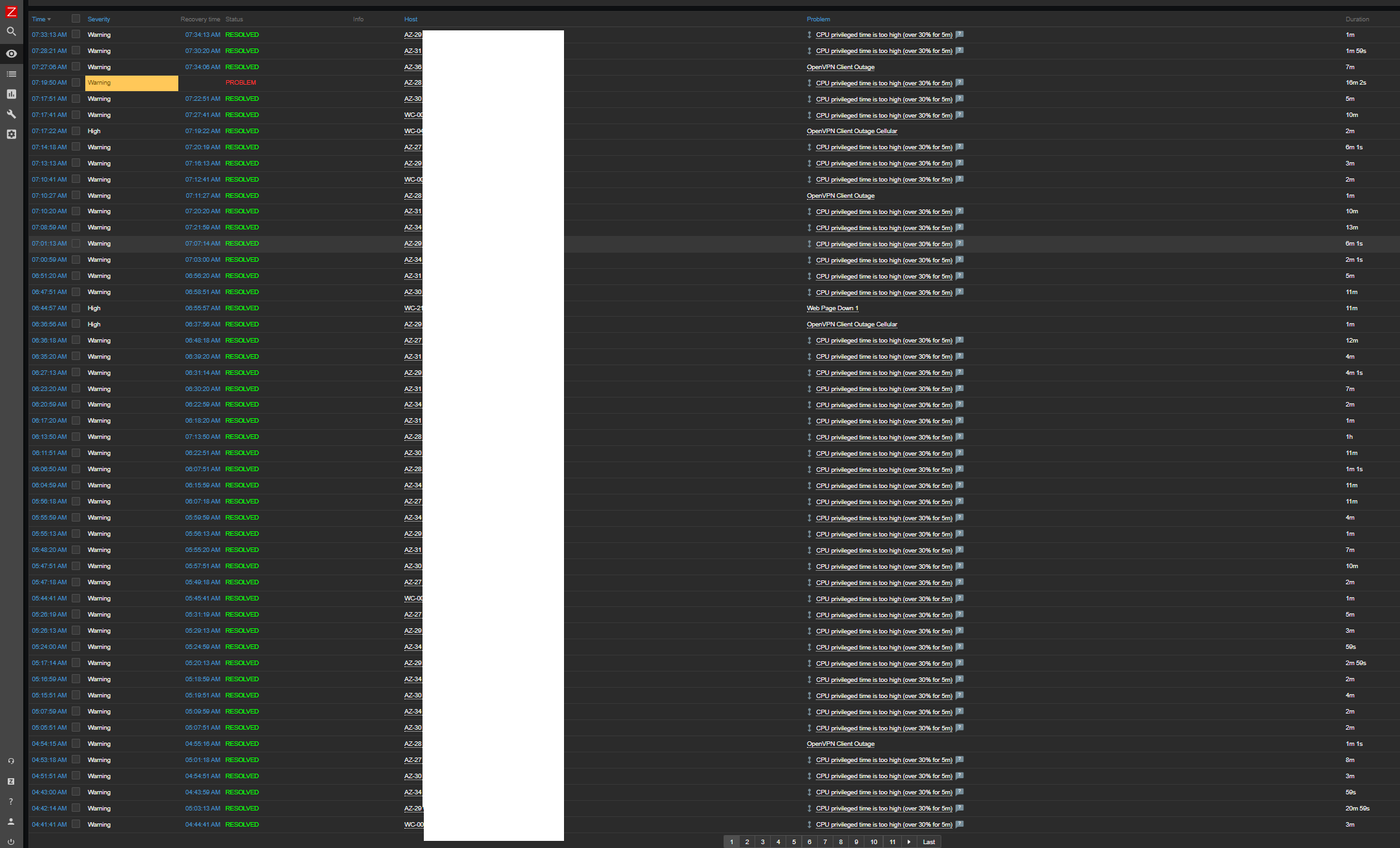

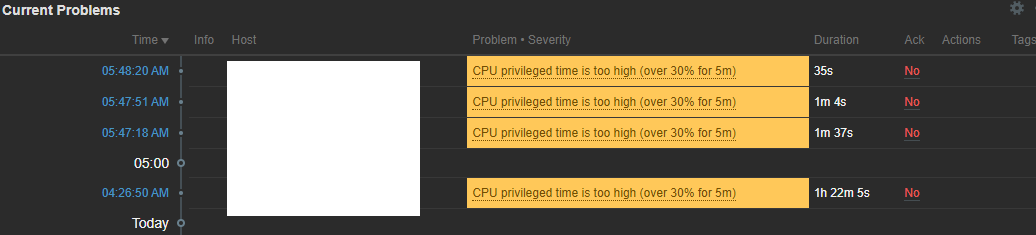

Posts: 102
Re: Linux server
Moar logs. Remember to add the five minute alarm threshold to the event duration in right column.
